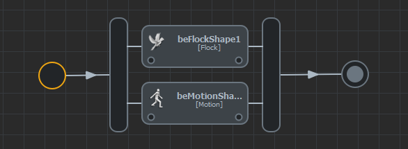

Finally, add behaviors
To finalize this basic Flock workflow, open the
BehaviorEditor
, double click on the
EntityTypeShape, and :
- drag and drop a
Flock Behavior
in
the execution flow. - drag and drop a Motion Behavior
over
the Flock Behavior to create a parallel operator combining both of
them, and select the previously exported golaem motion file (.gmo).
Note that for more advanced flock, a Locomotion Behavior with several movements should be
used instead.
A Flock Behavior and a Motion Behavior in a Parallel Operator, for basic
flocking

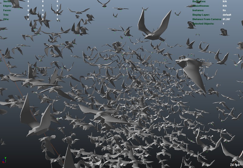

You should end with a moving flock of boids.
Finally, a flock of birds (previzualization)
You can get a better previzualization by selecting the EntityType in the outliner, and chosing "Render Previz" as Display Mode in General Display Attributes.
