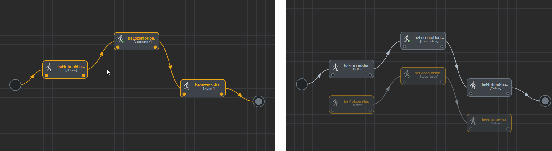

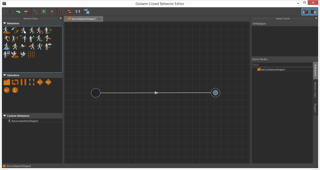

Select Behaviors/Operators in the Behavior Graph
  • Left-click *on the Behavior/Operator. Use *SHIFT key for multiple selection
  • Drag-and-drop inside the workspace to use the rubber selection band
Add a Behavior/Operator into the Behavior Graph
  • Drag-and-drop the desired Behavior/Operator from the Behavior Library into the workspace. A new Behavior/Operator will be created

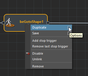

  • Use "Duplicate" in the context menu
  • Use CTRL+D on selected Behaviors/Operators to call glmDuplicateBehaviors command.
Duplicate Behaviors/Operators from the Behavior Graph

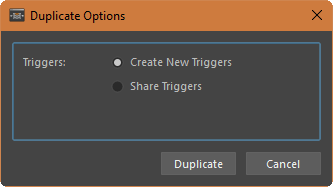

Duplicate Options
Use the Option box in the context menu to access the behaviors duplicate options
Access Duplicate Options
Duplicate Options Dialog
  • Create New Triggers: Creates new default triggers on the new behaviors
  • Share Triggers: Reuses the triggers from the original behaviors

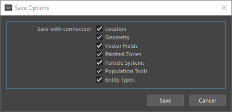

  • Use "Save Options" in the context menu to edit connected object saved with the behavior. Then use "Save".
Save a Behavior with Save Options
The new Custom Behavior is saved in a Custom Directory. This directory can be changed in the Crowd Settings or by choosing "Set Custom Directory" in the contextual menu of the Custom Behaviors Library.

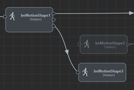

Enable/Disable Behaviors and Behavior Containers

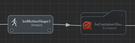

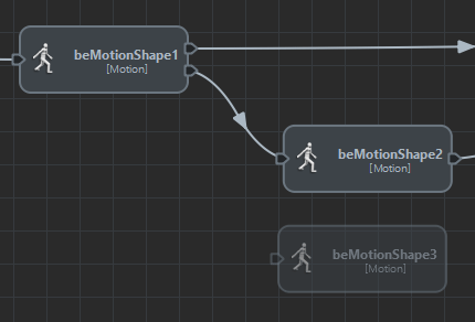

Behaviors and Behavior Containers can be disabled inside the Behavior Graph to help designing and debugging complex actions without modifying the Behavior Graph. The disabled Behavior/Behavior Container is overlaid with a disabled icon .
Enabled Motion Behavior and disabled Behavior Container
A disabled Behavior/Behavior Container is not evaluated during simulation, the next Behavior/Behavior Container marked as enabled will be played.

Notice that a Parallel Operator, with an exit mode set on "As soon as one behavior has ended", is not evaluated if one of its children is disabled.

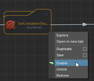

Enable Behaviors and Behavior Containers
  • On disabled Behaviors and Behavior Containers, Click on the Behavior/Behavior Container icon to switch the enable/disable status
  • Use the enable button  to enable selected Behaviors and Behavior Containers
  • On disabled Behaviors and Behavior Containers, use "Enable" in the context menu
Enable Behavior Container Context Menu

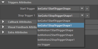

Share Behavior Triggers between Behaviors
  • Go in the Triggers Attributes on the Behavior and set the Starting or the Stopping Trigger of the Behavior to the same Trigger than the other Behavior you'd like to share the Trigger with. Once shared, the Triggers will be highlighted at the same time in the Behavior Editor:
To learn more about Behavior Triggers sharing, see Behavior Triggers.

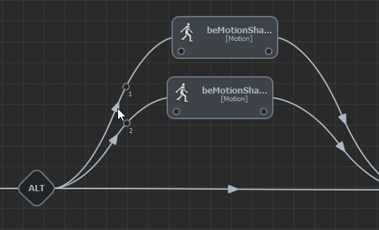

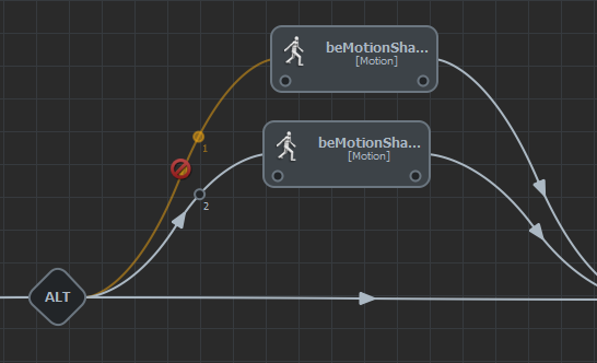

Notice that only links after Alternative/Random Operators could be enabled/disabled.
  • *Left-click *on the Link Arrow.
Enable/Disable a Link

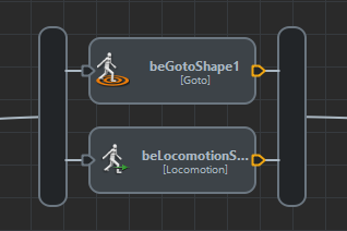

Add Behaviors into a Parallel/No Order Operator
  • Drag-and-drop the Behavior over the Parallel/No Order Operator
Note:
Tips: A Parallel Behavior will be automatically created if you drag-and-drop a Behavior over another Behavior
