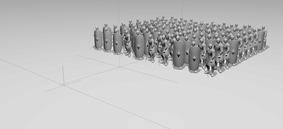

This tutorial will teach you how to use the Channel Operators to build an army that moves forward and stops in unison.

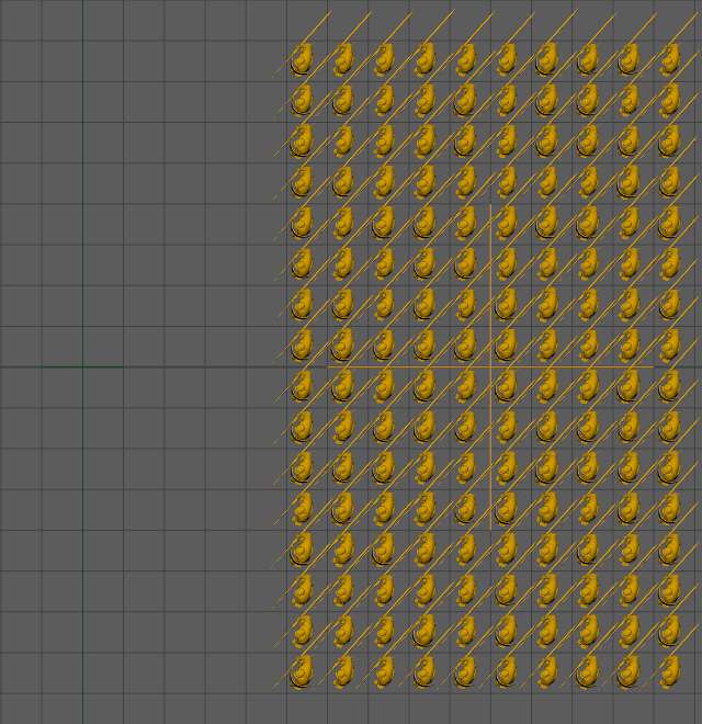

An army moving forward and stopping at a given location

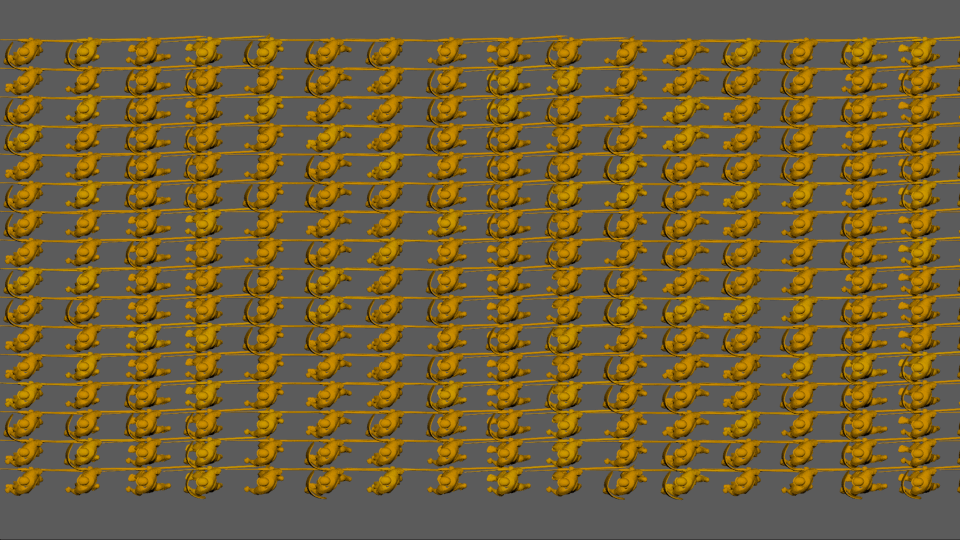

If you run the simulation at this point, the entity should not be moving. There is no navigation behavior to reach the target, and nothing else is driving the locomotion, so the entity should just play the rest motion.
The standing army

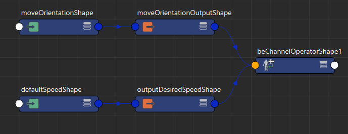

To let the Locomotion Behavior set the soldiers in motion, we'll use Channel Operators that will drive the desired speed and move orientation.
Graph of Channel Operators that set a moving orientation and speed for the Locomotion behavior to follow
2. Add a Channel Operator Behavior on the entity type, select the Channel Operator Behavior and Add a New Output Channel
3. Select the newly created output channel and configure the Output Channel to output the to Entity Desired Move Orientation, and rename it "moveOrientationOutput"
4. Select the "moveOrientationOutput" node, and add a previous ChOpInput
This input node will be the orientation in which the army should be moving.
Configure the Expression to "0" to have them move in the X direction, "180" to have them move in the opposite direction, or any value of your choice to choose the moving orientation. Rename the node "moveOrientation".
5. Select the Channel Operator Behavior again, and Add a New Output Channel
6. Select the newly created output channel and configure the Output Channel to output the to Entity Desired Speed, and rename it "outputDesiredSpeed"
7. Select the "outputDesiredSpeed" node, and add a previous ChOpInput
This input node will be the default navigation speed. Configure the Expression to "1.2" (or any other value depending on the scale of your entities) and rename it "defaultSpeed".

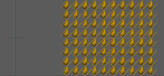

The graph of Channel Operators should now look like the previous screenshot. If you run the simulation at this point, the army should be moving, but not stopping in any case yet.
The infinite army

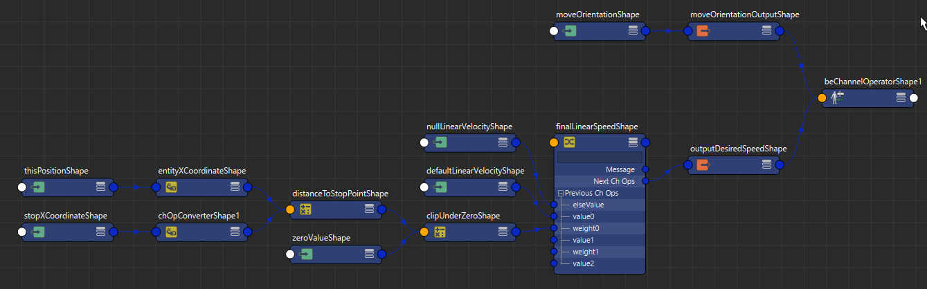

The graph of Channel Operators that allows entities to stop in front of the locator.
2. Delete the "defaultSpeed" node that was created in the previous part
3. Select the "outputDesiredSpeed" node, and add a previous ChOpMultiplexer
This node will interpolate the default navigation speed to slow down when needed.
As the input weight will be a distance (ie. not between 0 and 1), the Multiplexer has to be set in Interpolate With Normalized Weights (otherwize, the default speed would be multiplied by something greater than 1 as soon as the distance with the stop locator is greater than 1).
Rename it "finalLinearSpeed".
4. When the "finalLinearSpeed" node was created, it should have create a ChOpInput connected to the PreviousChOps[0] (this plug has an alias, it appears in the UI as elseValue) plug (if not, then create one).
This input node will be the zero speed. Configure the Expression to "0" and rename it "nullSpeed".
5. Select the "finalLinearSpeed" node again, and add a previous ChOpInput
This input node will be the default navigation speed. Configure the Expression to "1.2" (or any other value depending on the scale of your entities) and rename it "defaultLinearVelocity".
The weight of the "defaultLinearVelocity"should be 0 when the distance between the entity and the locator is 0. This will be done by using the difference between the X coordinate of the entity and the X coordinate of the "stopLine", and clipping to avoid negative values.
6. Select the "finalLinearSpeed" node, and add a previous ChOpOperation
This node will be the clipped result. Set the Operator to "max" and rename it "clipUnderZero".
7. Select the "clipUnderZero" node, and add a previous ChOpInput
This input node will be the clip value (0).
Configure the Expression to "0" and rename it "zeroValue".
8. Select the "clipUnderZero" node again, and add a previous ChOpOperation
This node will be the subtraction between the X coordinates of the entity and the "stopLine" locator.
Configure the Operator to "-" and rename it "distanceToStopPointShape".
9. Select the "distanceToStopPointShape" node, and add a previous ChOpConverter
This node will be the X coordinate of the entity.
Configure the Convert Mode to "Vector X Component" and rename it "entityXCoordinate".
10. Select the "entityXCoordinate" node, and add a previous ChOpInput
This node will be the full coordinates of the entity.
Configure the Expression to "this.position" and rename it "thisPosition".
11. Select the "distanceToStopPointShape" node again, and add a previous ChOpConverter
This node will be the X coordinate of the "stopLine" locator.
Configure the Convert Mode to "Vector X Component" and rename it "locatorXCoordinate".
12. Select the "locatorXCoordinate" node, and add a previous ChOpInput
This node will be the full coordinates of the "stopLine" locator.
Configure the Expression to "getAttr ("stopLine.translate");" and rename it "stopCoordinateShape".

If you run the simulation at this point, the army should be moving and stopping in front of the locator, but not avoiding each other.

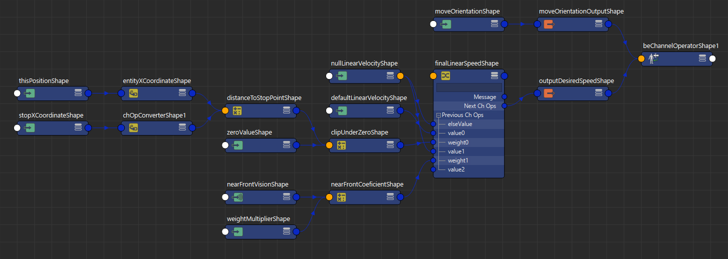

The final graph of Channel Operators for the stopping army.
1. Connect the next available PreviousChOps plug of the "finalLinearSpeed" node (the plugs of the multiplexor nodes uses aliases, so it should be called value1 in the node editor) to the NextChOps available plug of the "nullLinearVelocity" (hold middle click on the nullLinearVelocity.NextChOps plug, and release it on the finalLinearSpeed.value1 plug)
At this point, we could directly connect the weight1 plug to the vision, but if you try, you will realize that even if entities slow down behind other, they won't stop moving before reaching the stop line.
The reason is that the "finalLinearSpeed" interpolator also interpolates with the distance to the stop line that is connected onto value0 and weight0, and it adds a bit of speed as long as the distance to the stop line is not 0. To ensure the sensor input vision is taken into account with more weight than the distance to the stop line, we'll simply multiply its value by an arbitrary value.
2. Select the "finalLinearSpeed" node, and add a previous ChOpOperation . It should connect itself to the next available plug, which should be weight1.
Set the Operator to "x" (multiplication) and rename it "nearFrontWeighted".
3. Select the "nearFrontWeighted" node, and add a previous ChOpSensorInput
Configure the Depth with the distance at which you want your entities to stop behind others (for instance ours is configured to [0; 0.5]), and the Angle to something narrow enough to not stop due to entities on the side (let's say [-30; -5; 5; 30]).
Rename it into "nearFrontVision"
4. Select the "nearFrontWeighted" node again, and add a previous ChOpInput
Configure the Expression to "1000" (you can try different values, as it's an arbitrary one), and rename it into "weightMultiplier"
And that's it, you should now witness an army stopping in unison in front of your locator.
