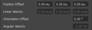

Notice that the provided motions need to define a root translation and/or delta orientation (used to compute the original velocity of the motion). Using in-place motions will not work with the locomotion behavior. See the Motion Tab of the Character Maker or the Motion Clip attributes to see how to edit root translation/delta orientation.

The linear and angular velocities of the motions can be seen in the Motion Tab of the Character Maker:

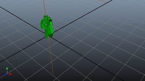

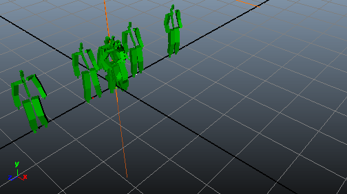

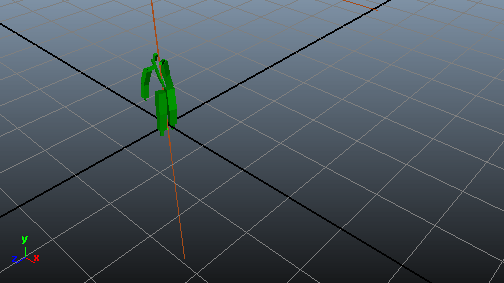

The Locomotion Behavior automatically uses motions that have a null linear speed to improve the starting animation:
![]() With turning null linear speed motion |
![]() Without turning null linear speed motion |
