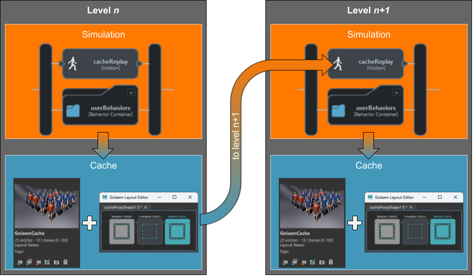

Crowd Levels are a concept that lets you make an infinite number of iterations with simulations and caches/layout.
The principle is that a cache and its layout can be re-imported into a new simulation, where it will be replayed on each entity as if it was a simple animation, through a Motion behavior.
Once the cache is replayed in the simulation, you can add new behaviors in parallel, create new entity types, or anything that is usually done in simulation.
  • It's possible to go back in each level, change the simulation/the layout, and refresh everything up to the top level
  • There is no limit in the number of levels that can be added on top of each other
Golaem levels workflow

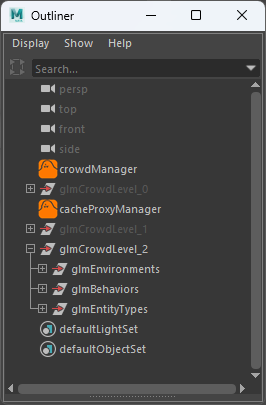

Levels are handled by the Crowd Levels Manager: it lets you navigate through levels, and to add new ones.
When creating new golaem nodes at any level, they will automatically be grouped under a glmCrowdLevel_n Maya node, and inactive levels will be greyed out in the Outliner:
Levels organization in the Maya Outliner
