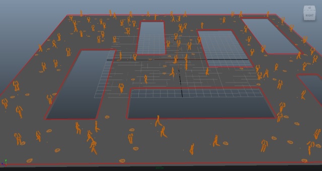

Different ways of setting up navigation
Golaem provides various way of making your characters navigate in a scene. This page provides an overview of the different methods and redirect you to the in-details tutorials.
The Navigation and Goto behaviors rely on Golaem path-finding & avoidance technologies to make your characters find their way in your scene and avoid other characters. They are very quick to setup and can be easily customized (e.g speed, targets, ...).
This is the "standard" way of setting up navigation with Golaem. Other methods are generally fitted to a few particular use case.
Pros & cons:
  • quick and easy to setup
  • requires using the Locomotion Behavior for animation (which is not a problem in itself, but in some cases it is easier to just use a Motion Behavior, see alternative method below)
For an example, see Populating city streets with Golaem

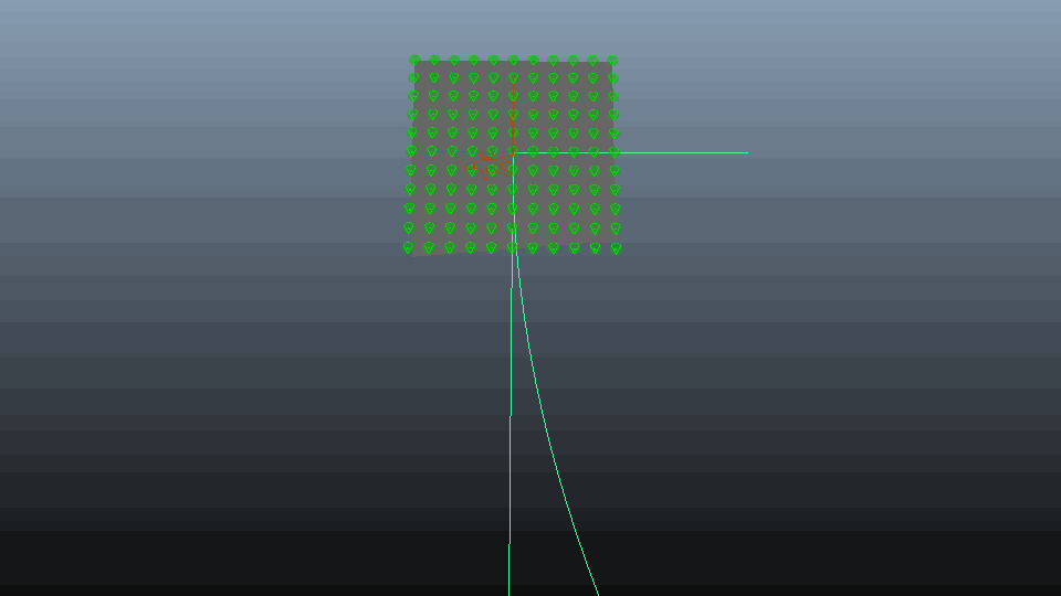

Vector fields
While the Navigation and Goto behaviors are very handy, sometimes you want to control very precisely the trajectories in a given location of your environment. In these cases, Vector Fields can be a useful addition to a Navigation/Goto behaviors setup.
For an example, see Driving Entities with Vector Fields

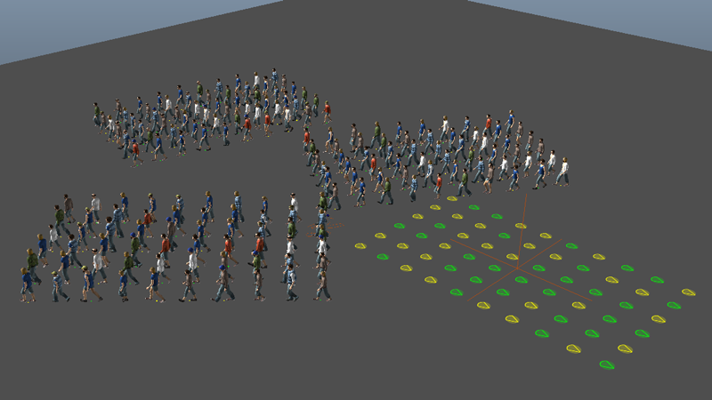

SetFormation Behavior
The Navigation/Goto Behavior will make your characters navigate individually, but if you need them to navigation as a group, you need a bit of extra work. The SetFormation Behavior enables you to benefit from Navigation/Goto Behaviors while forcing characters to respect a given shape (global or per small groups).
Pros & cons:
  • Keep benefits of Navigation/Goto
  • Can even take multiple shapes in input and make characters transition from one shape to another.
  • A bit more complex to setup than AdaptPosition (see below)
  • Does not handle very well obstacles in the middle of the formation shapes
For examples, see Keep a formation using the SetFormation Behavior or  Create your logo with crowds

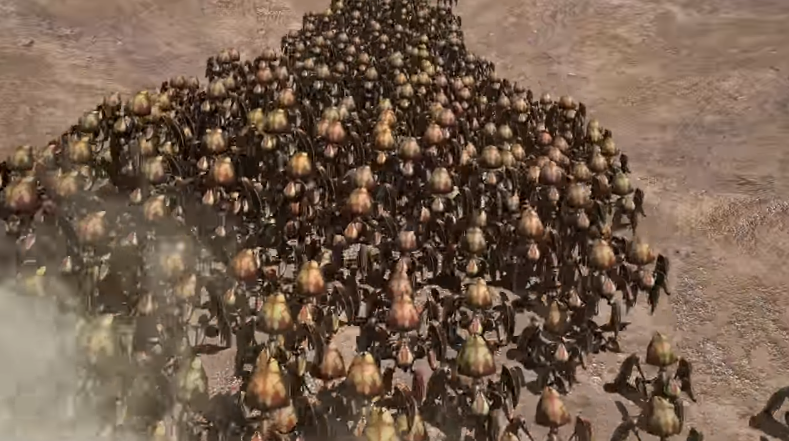

AdaptPosition Behavior
The AdaptPosition Behavior snaps your characters to another object (polygon, particles...). It is very useful when you want to keep a precise control over the character position, and may be an easier way to create a formation.
Pros & cons:
  • Super easy to setup
  • Can be used with emitters on particles
For example, see Keeping a formation using AdaptPositionBehavior
