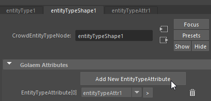

- In the Entity Type Attribute Editor, click on the Add New EntityTypeAttribute button in the Golaem Attributes section

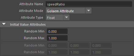

| Attribute Name | Name of the attribute |
| Attribute Mode | Can be a Golaem Attribute or a Maya Per-Particle Attribute |
| Attribute Type | Type of the attribute, Float, Int or Vector |
| Random Min | Random float or int value lower bound |
| Random Max | Random float or int value upper bound |
| Random Min (Vector) | Random Vector value lower bound |
| Random Max (Vector) | Random Vector value upper bound |

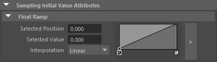

| Float Ramp | The cuve ramp defines the distribution in the Min Max range defined above |
