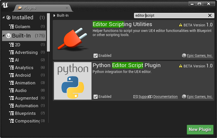

Load the Python Editor Script and the Editor Scripting Utilities Plugins
In Unreal Engine Plug-in Window (Edit / Plugins), enable both the Python Editor Script and Editor Scripting Utilities plugins:

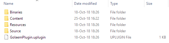

The Golaem for Unreal Engine plug-in can be as an extension in the Golaem card of your Autodesk Account.
It is made of four directories and one .uplugin file:
Adding Golaem For Unreal Engine Plug-in to your Environment
Then, for Unreal Engine to be able to find the Golaem For Unreal Engine Plug-in, it must be added in the Plugins/GolaemPlugin directory of your Unreal Engine Project. If correctly installed, you should be able to set it in the Plug-in list of Plug-in Window (Edit / Plugins):
