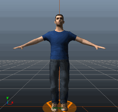

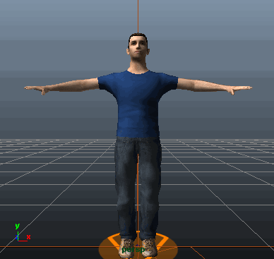

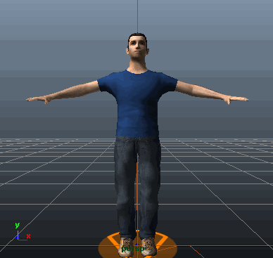

Priorities and weights can be configured to handle animation concurrency and control accurately the interpolated blend. For instance, considering the following configuration for the 2 interpolated animations in the previous example:
| Priorities/Weights Configuration | Main Blend Pass Output Animation |
| A-Stance priority is higher than Waving T-Animation priority | ![]() A-Stance |
| A-Stance priority is equal
to Waving T-Animation priority A-Stance weight is 0.75 Waving T-Animation weight is 0.25 |
![]() 75% of A-Stance 25% of Waving T-Animation |
to Waving T-Animation priority A-Stance weight is equal to Waving T-Animation weight |
![]() 50% of A-Stance 50% of Waving T-Animation |
to Waving T-Animation priority A-Stance weight is 0.25 Waving T-Animation weight is 0.75 |
![]() 25% of A-Stance 75% of Waving T-Animation |
| A-Stance priority is lower than Waving T-Animation priority | ![]() Waving T-Animation |
