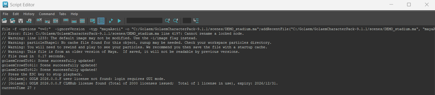

After launching a simulation (otherwise the license is not used hence not checked), open your Script Editor (Windows/General Editors/Script Editor)
You should see a message about your license status
Golaem support two types of license, so you will almost always have a "not found" message for one or another type of license.
- The user license is the one related to the Autodesk User you sign with in your Maya
- The ClmHub license is the one you could get in a studio who is using a network license server
