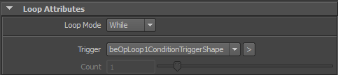

Loop Attributes
Loop Attributes of a Loop Operator
| Loop Mode | Define the mode to use to run the Loop Operator:
| Trigger | The related condition, e.g. the Trigger to evaluate in order to
stop the loop (click on |
| Count | The related number of loop to perform with the For Mode. |
to select this Trigger
in Maya). This Trigger is only available in the While/Do While
Mode.
