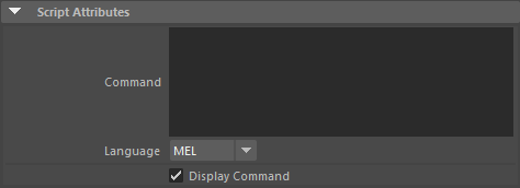

Script Attributes
Script attributes of a Script Behavior
Command MEL/Python script command called when the Behavior is run
Language The command language, MEL or Python
Display Command Display or not the command in the Script Editor
This command may contain special tags such as #pid#, #ps# or #gid# to interact with particles (see Technical Documentation).
