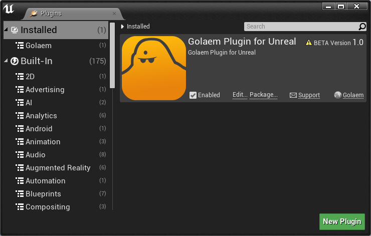

Loading The Golaem plug-in in Unreal Engine
Once the plug-in is properly installed, you can load the Golaem plug-in in Unreal Engine. If correctly installed, you should be able to set it in the plug-in list of plug-in Window (Edit / Plugins):
Once the plug-in dependencies (PySide) are properly installed, you can try opening the About Golaem / Library Tool from the Window > Golaem menu. If correctly installed, you should be able to set the corresponding window / editor. If not, please review the Golaem For Unreal FAQ.

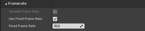

Setting Up Fixed Frame Rate in Unreal Engine
To run simulations or replay Simulation Caches properly, the frame rate within Unreal Engine needs to be fixed. This can be set in Edit / Project Settings > Engine > General Settings > Framerate:
