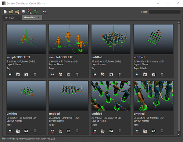

Simulation Cache Library File (.gscb) is a JSON file which stores a library of previously exported Simulation Cache Files and their Layout Files as Library Items. Those items can then be drag and dropped in a scene. It can be generated using the Simulation Cache Library Tool or every time a Simulation Cache is exported using the Simulation Exporter.
And the corresponding .gscb file:
