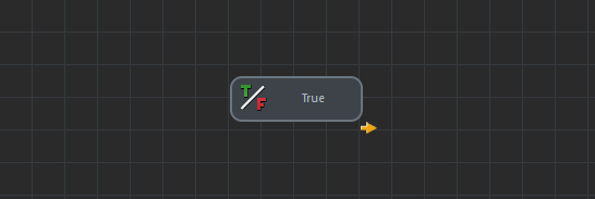

When an Behavior is created, two Trigger Containers are automatically created and attached to it: a Starting Trigger and a Stopping Trigger. Those Trigger Containers will be used to store a Trigger Graph. Here what does a Trigger Graph looks like by default in a Starting Trigger:

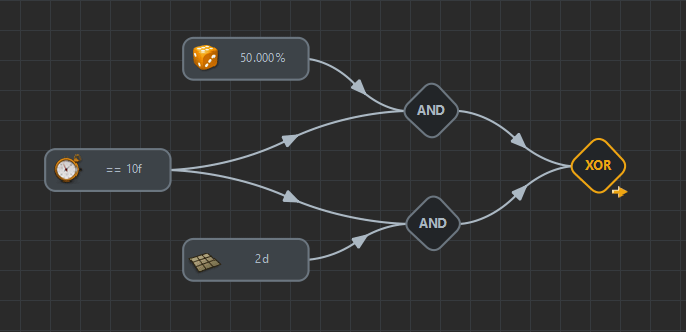

Other Triggers can be added and linked in a Trigger Graph:
Modify the root Trigger will update the Trigger Graph to execute each Triggers and Trigger Operators prior to this root Trigger:
