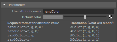

V-Ray User Color attributes
User attribute name Name of the vector user data attribute to read in the rendered mesh. The name of the user data should be the same as the one defined in the Shader Attributes of the Mesh.
Default color Default value to return if no matching user data was found in the Character File
