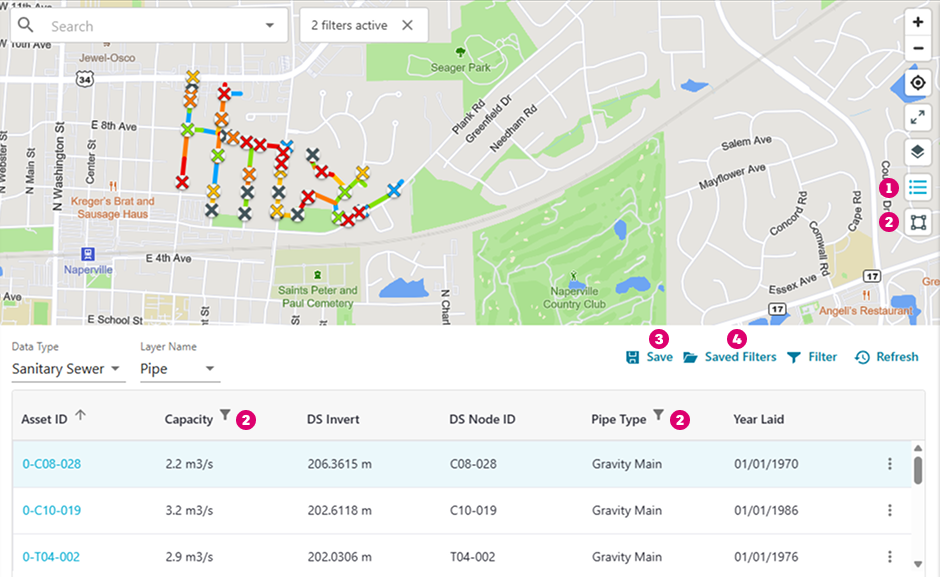

You can save filters from the Network map by opening the asset list [1], applying filters or using the draw polygon tool to filter [2], then saving [3]. You can also save filters for spatial data layers.
Once saved, you and others can access the saved filters [4] and re-apply them to the list / map.
Important: It is not currently possible to delete or rename saved filters.

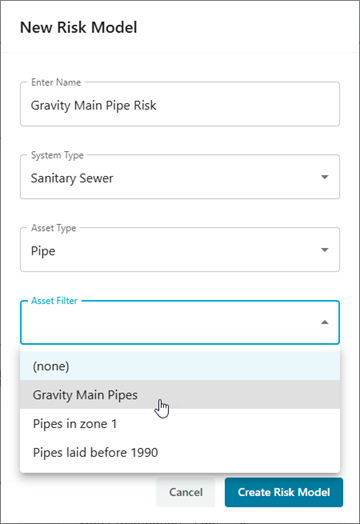

You can use your saved asset filters to create and run risk models for a subset of your assets. When creating a new risk model, select the saved filter.
