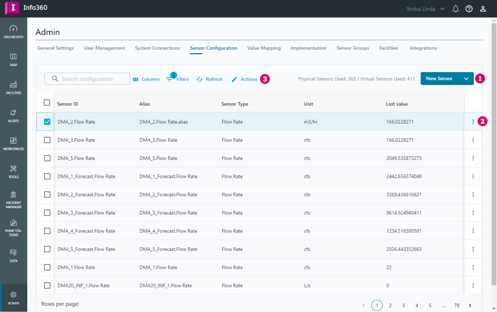

From the Sensor Configuration page (in Admin) you can:
  • [1] Create sensors (single or bulk) and upload data. Find these actions in the New Sensor drop-down.
  • [2] View, edit or test a sensor's configuration, view a sensor's latest data points, or locate a sensor on the map (if location is set). Find these actions in the three dots menu.
  • [3] Delete sensors or sensor data, or resample sensor data. Find these actions in the Actions menu once you have selected one or more sensors.
    Note: Virtual sensors created from the analytic, mass balance, or ILI tools need to be deleted in those tools.
