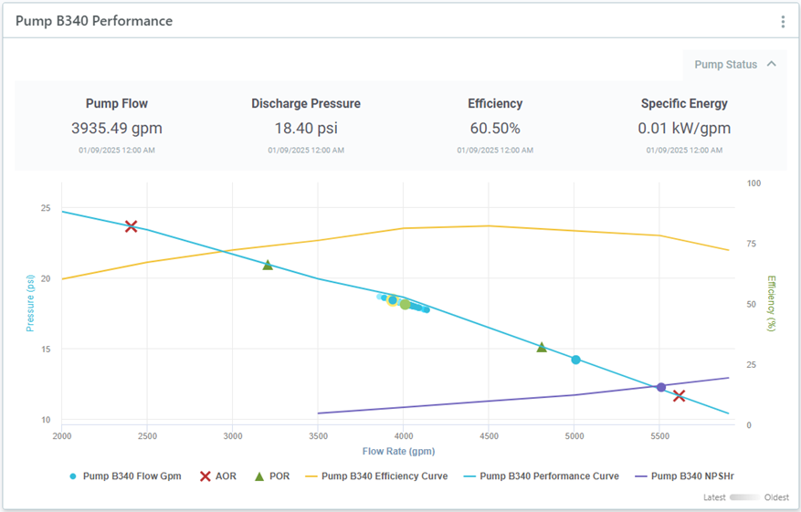

Example Pump Performance Chart
In this chart, several references and properties have been added, and we can see:
  • In blue, Flow vs Pressure for Pump B340, as well as the manufacturer pressure curve. The latest data point is highlighted in yellow.
  • In purple, the manufacturer NPSHr curve.
  • In yellow, the manufacturer efficiency curve.
  • The Pump Rated Capacity point represented by a large green dot. You can see how far actual pump performance is from optimal performance.
  • The Preferred Operating Range (POR) represented by green triangles.
  • The Allowed Operating Range (AOR) represented by red crosses.
