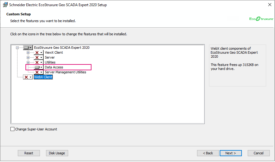

  1. Go to the Geo SCADA Expert download page and download the appropriate version.
  2. Run the installer and when prompted, select Custom Setup and then deselect everything except Data Access and proceed with the installation.
  3. When installation is complete, you will have a driver installed called "ClearSCADA Driver". You can find this using the Windows ODBC Data Sources tool.

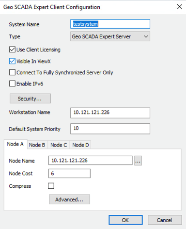

  1. Run the Geo SCADA "Configure Connections" tool, click Add, and then fill out the following fields:
    1. System Name: The name you enter here will be referenced in the ODBC Data Source tool (next step).
    2. Workstation Name (or IP)
    3. Node Name (or IP).

The default port is 5481. The Geo SCADA Server will be listening on port 5481 and needs to have it opened as an inbound firewall rule.
To configure a different port, in the Geo SCADA Configure Connection tool, click on the Advanced button and set the port there.
