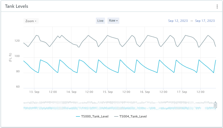

Create a historical chart to show trends and behavior over time.
For example, you may want to see trends in how tank levels fluctuate over time.

- Choose if you want to turn the Live button on (green) so that the chart gets updated with the latest data any time it is refreshed. Or, if you want to keep specific dates set for a historical chart, leave this off.
Note: For the Live button to be on, the chart end date must be set to today. Moving the end date either via the slider or the date picker will deactivate the Live button.

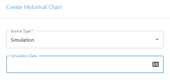

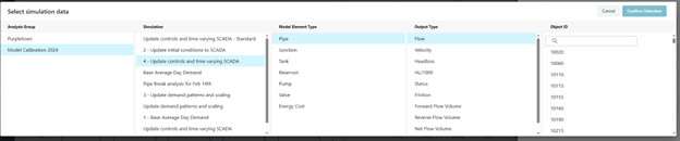

To add a simulation result to a historic chart, for example to compare to an observed SCADA data set:
- Choose the Simulation data source in the Source Type picker.
- In the Simulation Data field immediately below, use the selection dialog to choose the simulation data source desired.
- Select the desired Object ID, also known as the ModelElementID using all of the preceding field selections to the left, to get the specific simulation data set to examine.
