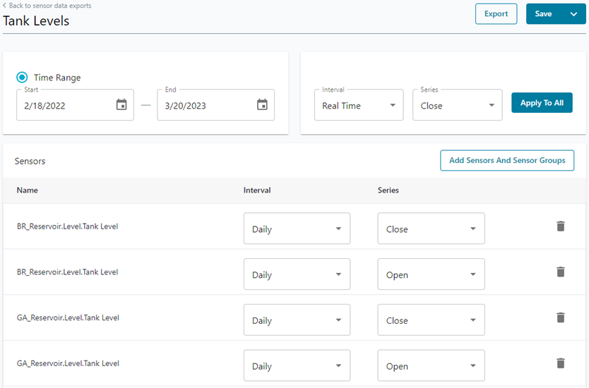

Add sensors to export
  1. In the list of exports, click on the row of the export you created to open it.
  2. Click on Add Sensors And Sensor Groups.
  3. Select the sensors and/or sensor groups you want to export data for, and select a default interval and series type. Then click Add.
  4. You can adjust the interval and series types for each sensor if you wish.
  5. You can also add the same sensors again and choose different intervals and series types in order to export different data sets for the same sensors.
  6. When you have finished adding sensors, click Save in the top-right corner.
