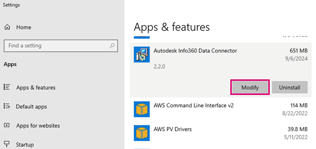

  2. Ensure that only one data connector is installed and running. The same installation code cannot be used for multiple data connectors.
    If unsure, you can generate a new installation code from the Admin Implementation page. Then, either re-install the data connector or run the MSI Modify operation from the Windows Apps & Features settings page.
