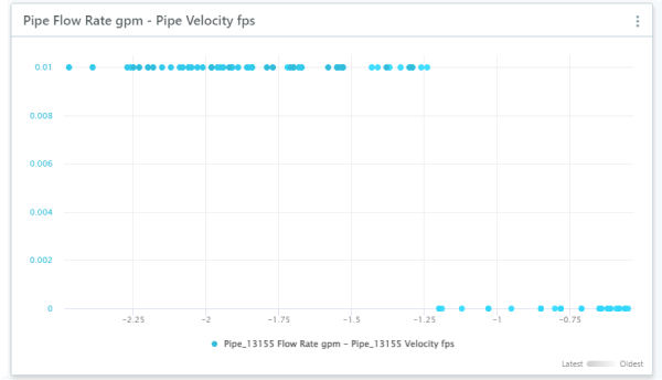

Create a Scatter Chart to visualize the relationships between two sets of time series data.
For example, a scatter chart for Flow and Velocity can provide some indication of obstructions (roots, grease) in the system.
