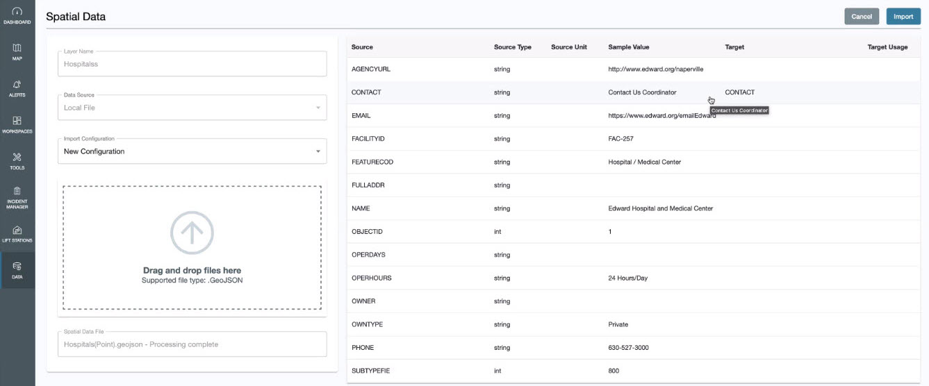

- Drag and drop your file to upload.
- If you are importing via a GeoJSON file or Shapefile:
- Drag and drop your file to start the upload.
If you are importing via an ArcGIS integration:- Click Select Layer.
- Select a feature service, then select a Layer.
- Map the fields you are interested in seeing in
Info360 Plant. In the table, click on a row and select a Target Field.
If you want to configure the Source Unit, select a Target Usage from the drop-down and you will be able to select a related Source Unit.
- Once the mapping is complete, click Import.
- Enter a Configuration Name. This mapping configuration will be saved for future GIS updates and will be available under the Import Configuration option.
