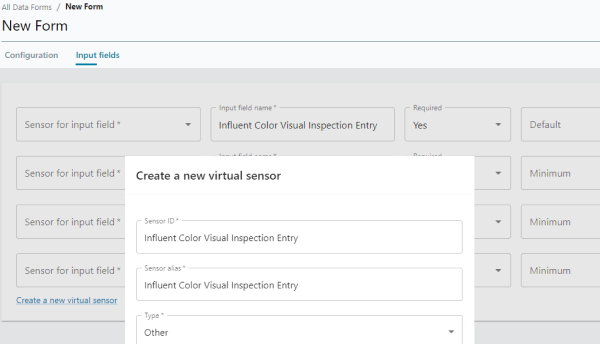

Oct 23 | Create virtual sensors to store the data entered via Info360 Plant forms.
Each input field in a form requires an associated virtual sensor. You can create these either during the form creation process or if you are an Admin, you can create them beforehand in bulk in Admin
Sensor Configuration.
Once data is entered in the form, you can use the associated virtual sensors and their data in analytics and charts.
Admins can see a list of all sensors, including virtual sensors, in Admin
