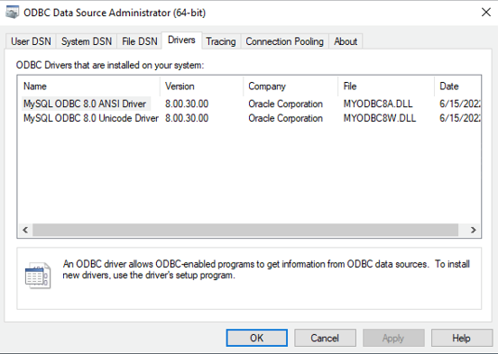

- From the MySQL Community Downloads page, download and run the 64-bit MSI Installer.
- Once the installation is complete, open the ODBC Data Source Administrator (64-bit) and check that you can see the MySQL drivers on the Drivers tab.
