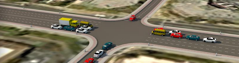

Use the Traffic Simulation tool to analyze traffic flow through intersections, display color-coded traffic analysis results, and generate traffic simulation animations to play in your model. Use the Traffic Analyst panel to specify advanced demand matrices, profiles, vehicle types, driver types, and other variables. Or, use default traffic demand for a quick demonstration.
