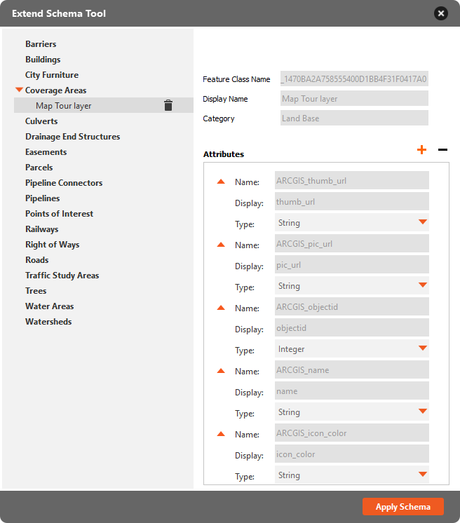

The Extend Schema tool will display.
Select a feature class from the left sidebar to review the name, display name, category, and associated attributes.
- Click the drop-down arrow next to a feature class name to review subsets of that feature class.
- Hover over a feature class name in the left sidebar and click the orange plus button to add a new subset to that feature class.
- Click
to delete a feature class or subset.
Use the Attributes controls to add, remove, or modify attributes for the selected feature class or subset.
Click Apply Schema when done.
