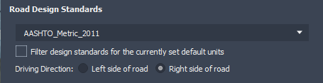

Road design standards provide definitions and rules for planning roads and component roads in your model. You can choose Road Design Standards that are best suited for your geographic location, units of measurement, and other compliance parameters specific to your project.
Click Manage > Model >
(Model Properties).In the Model Properties palette, in the Road Design Standards area, select the standard to apply.
