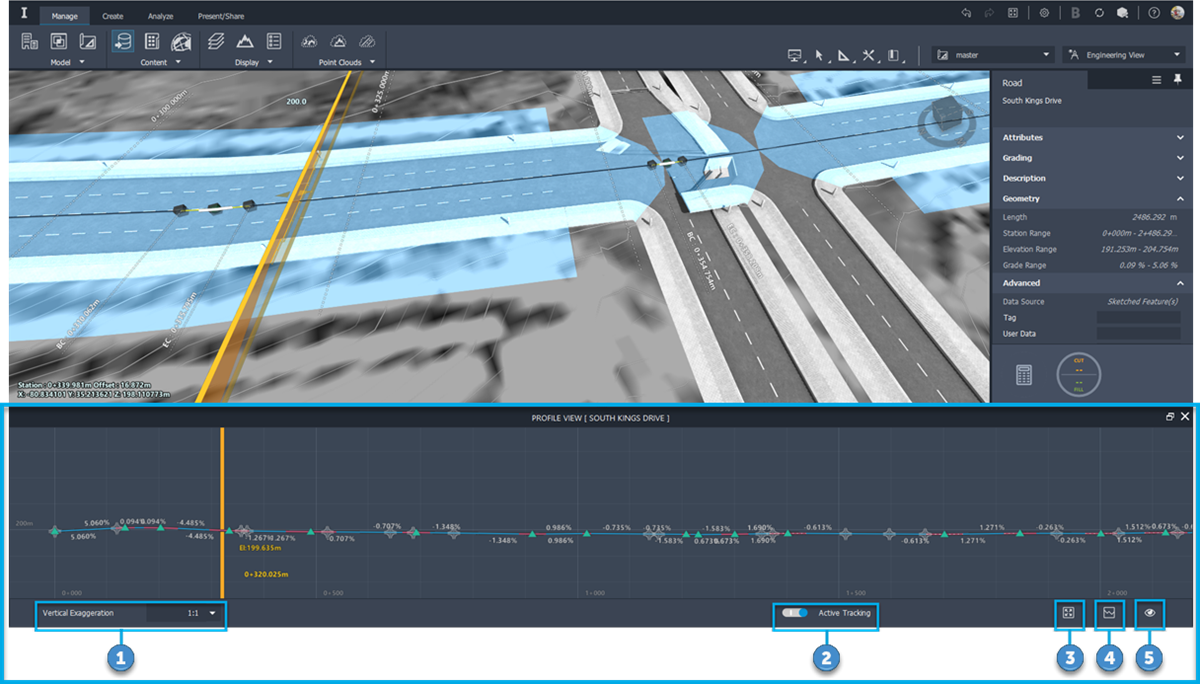

Profile View Panel
  1. Vertical Exaggeration: control the ratio by which the Profile View grid is vertically exaggerated.
  2. Active Tracking: when toggled on, this enables the yellow station tracker to display in-canvas as you move your cursor in-canvas or in the profile view. The station tracker also displays elevation and station offset values in the profile view in yellow, once you enable active tracking.
  3. Fit to View: Zooms out to view the extents of the road profile.
    • Zoom to a range of stations by using the mouse wheel to zoom in or out of the profile. Note: As you zoom in, more information is displayed in the Profile View. For example, horizontal critical stations are displayed.
    • Pan along the length of the road by dragging the left mouse button.
  4. Road Profile Options: Choose Recreate Profile to redraw the road profile or choose Drape Profile to drape the road's vertical profile to the terrain. Note: The drape is computed with a variable frequency depending on the road and terrain geometry. The draped profile will not exactly match the terrain elevation in rapidly changing areas along the roadway, but it should closely approximate terrain elevation.
  5. Asset toggles: expand the asset toggle and checkmark the types of feature you want to display in the Profile View.
    Asset Toggles

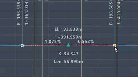

    • Symmetric Parabola Curve: selecting and moving either end of the curve changes both ends equally.

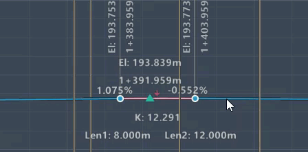

    • Asymmetric Parabola Curve: selecting and moving one end of the curve only changes that side, maintaining the location of the other end.

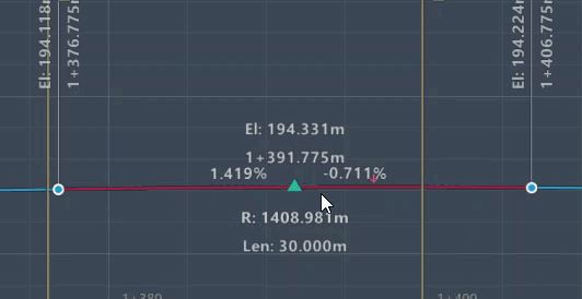

Symmetric Parabola Curve Selecting and moving either end of the curve changes both ends equally. images
Asymmetric Parabola Curve Selecting and moving one end of the curve only changes that side, maintaining the location of the other end. images
Circular Curve Displays an editable Radius field to change the radius of the curve. images
