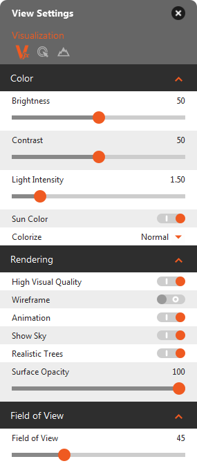

Use the View Settings panel to control a range of visual and lighting effects. Use these options together with Sun, Wind, and Cloud settings Sun Wind Cloud to customize your model's appearance.
From the View drop-down menu, click view settings to configure view settings for the active view.
view settings
Note: The view settings are defined for and stored with the view and may differ from one view to another. These view configurations are saved locally and are available in all models you open. Collaborators of cloud models can customize views as needed without affecting the view settings for others.
Visualization Panel
visual effects
Brightness: Range between darkest and lightest colors in the image. High brightness reduces amount of black in colors, image looks like overexposed photograph. Low brightness increases amount of black in colors, image looks like a photograph taken with insufficient light.
Contrast: Lighter tones get lighter and darker tones get darker. Light Intensity: Adjusts overall brightness and intensity of colors uniformly.
Sun Color: Add a tint to simulation sun position.
Colorize: Normal, Grayscale or Sepia.
High Visual Quality: Rough versus high resolution display of the model.
Note: This setting is specified for the view, but the Display Detail value (level of display detail for terrain, generated objects, and imported 3D models) is specified for all views in the model in Application Options3D Graphics tab.
Wireframe: Reduces features to three-dimensional skeletons, displaying only lines and vertices.
Animation: Turns on/off animations of water waves and clouds. Turning this OFF will cause waves and clouds to remain still.
Show Sky: Turns on/off the display of the sky background.
Realistic Trees: When enabled, all Trees layer objects are represented realistically. When disabled, trees are represented by a consistent, simplified tree model scaled to the correct height of the object. You may want to toggle this option off for an engineering view where a clean view of the model is useful for editing purposes.
Note: This option only affects objects of the type "Tree." The following objects are not affected:
  • City Furniture objects with a tree style
  • Road/Rail decorations with a tree style.
Surface Opacity: Make the model surface transparent to see features below the terrain.
Field of View: A wide FOV zooms out from current view and flattens features, like a wide-angle lens on a camera. Features appear smaller and further away than they actually are.

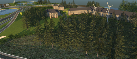

Realistic Trees When this effect is enabled, all Trees layer objects are represented realistically. Realistic Trees

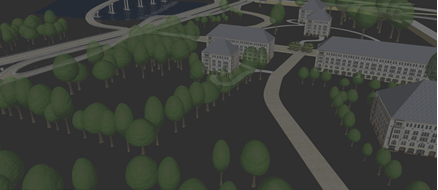

Simplified Trees When the Realistic Trees effect is disabled, trees are represented by a consistent, simplified tree model scaled to the correct height of the object. With the simplified trees, you can see the positions and dimensions for the trees, but a transparency property ensures that the trees do not obscure other model objects. Simplified Trees
