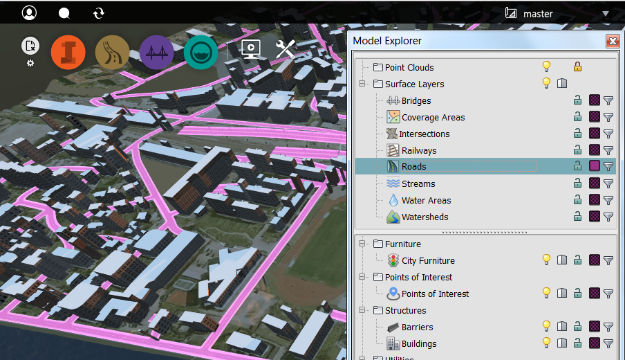

Select and Highlight Features
Selected features are highlighted in yellow and surrounded by a bounding box.
When multiple features are selected, the bounding box encompasses all of the selected items, and anything you do affects the entire selection.
Use highlighting to see the difference between various categories of features.
By default, features are highlighted in yellow. You can change the highlight color for any feature class or subset.
Note: Highlighting does not select features.
