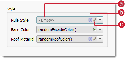

  4. Choose one of the following options:
    rule style
    a. Click to expand the drop-down list, and select a data source property to specify that property as a rule style.
    Note: If you specify a data source property as a Rule Style, you can also define style rules to map individual values of that property to individual styles. See below for an example.
    b. Click to create an expression to filter the Rule Style property you specify.
    c. Click to open the Style Chooser and select a default style to apply to all the feature(s) in the feature class. You can create Style Rules to override the default Rule Style using another model property field such as Manual Style.
