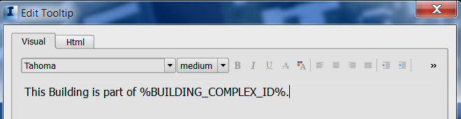

If you include a property in a tooltip, all individual features that contain a value for that property will display that value. For example, a feature class tooltip for buildings tooltips could include the BUILDING_COMPLEX_ID property.
edit tooltip
Each building would display a tooltip that includes its corresponding BUILDING_COMPLEX_ID value. If a building does not contain a value for BUILDING_COMPLEX_ID, its tooltip will be blank.
