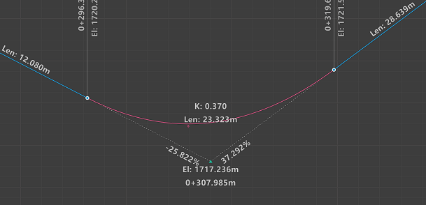

To review and modify a vertical curve in the Profile View
You can edit some attributes of a vertical curve, such as curve length and K value, directly in the Profile View.
Select a component road.
Right-click and choose Show Profile View.
In the Profile View panel, click on a PVI.
To modify curve attributes directly, click on one of the fields, type the new values, then either press Enter or click out of the field. Note: A message displays if the value makes the curve unsolvable.
