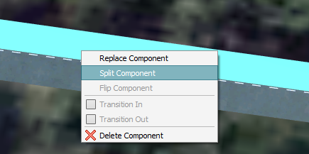

  1. Select the roadway component that you want to split.
  2. Right-click the selected component and click Split Component.
    split component 1

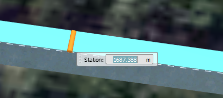

  3. Slide your cursor until the gold placement grip is positioned where you want to split the component.
    split component 2

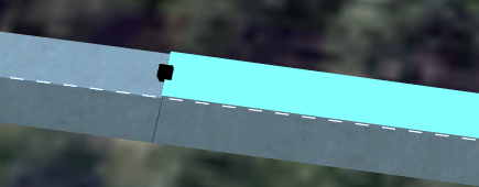

  4. Click to split the component. When the split is complete, a black control grip appears where the component was split.
    split component 3
