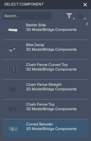

Select a component or corridor road, right-click and click Place Decorations.
Select the component to place on the seam.
Note: Click the filter icon to filter by 3D Model and/or Parametric Model.
