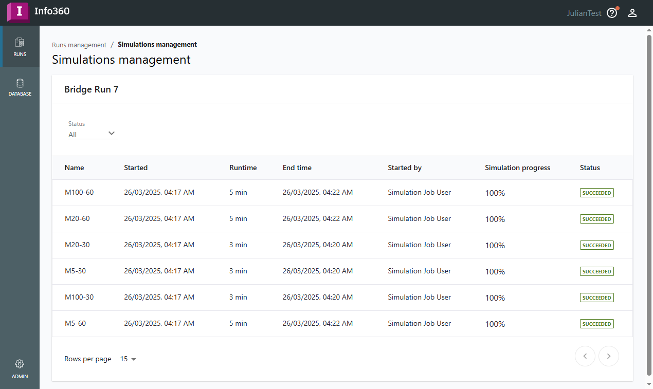

This page is displayed when you click a row in the Runs management page. It lists details of all the simulations in the selected run, including their simulation progress and status.
It includes a Status drop-down list that contains a list of simulation statuses. Use this to limit the list to simulations with the selected status.

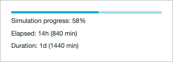

For ICM, it shows the simulation progress as determined from the elapsed time and duration. Hovering over the Simulation Progress percentage shows the following information:
- Elapsed - Time indicating the current progress of the simulation.
- Duration - Time indicating how long the simulation runs (as specified in ICM).
- Simulation Progress - Elapsed time / Duration.

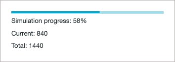

For WS Pro, it shows the simulation progress as a determined from the current and total timesteps. Hovering over the Simulation Progress percentage shows the following information:
- Current - Current progress, in timesteps, of the simulation.
- Total - The simulation divided into timesteps.
- Simulation Progress - Current timesteps / Total timesteps.
Status
This column shows the live update of the simulation status.
The status may be any of the following:
- Created
- Queued
- Started
- Running
- Succeeded
- Failed
- Cancel a simulation. Only available for ICM simulations whose status is Running.
