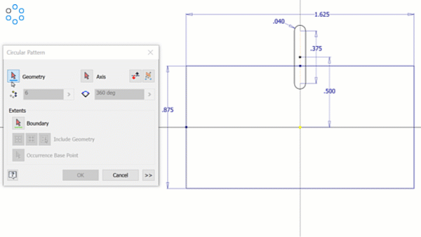

Sketch Patterns
You can now use a sketched boundary and pattern sketch geometry only within that boundary. You determine which geometry is used in the pattern, such as only within the boundary, all with centroids inside the boundary, or by using a base point where all geometry with base points inside the boundary are used.
