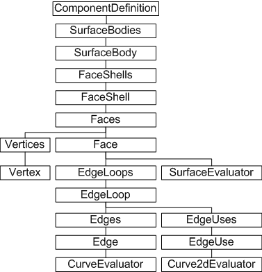

Boundary Representation (BRep) Object Model Diagram
BRep Object Model Diagram
Working with the BRep API
The BRep API has a number of hierarchical objects. The topmost is the SurfaceBodies collection of SurfaceBody objects. A SurfaceBody object represents a discrete part.

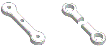

A FaceShell object represents a connected set of faces. A FaceShell for a simple cylinder has the two planar end faces, and the non-planar side face. Typically a SurfaceBody contains a single FaceShell object, but it is possible to have more, as in the following illustration:
The SurfaceBody on the left has one FaceShell. Increasing the hole diameter results in the SurfaceBody on the right, comprised of two FaceShell objects.

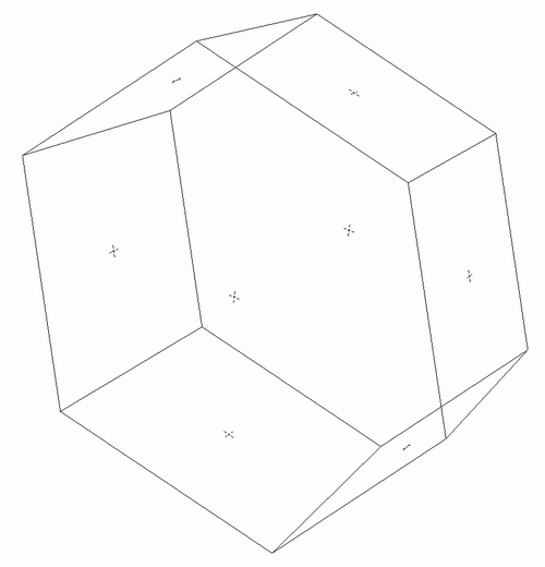

The sample places new sketches and sketch points in the part document. The sketch points are located at the center of all planar faces. For example, a tapered hexagonal solid results in placement of the following sketch points (here shown in wireframe mode):
