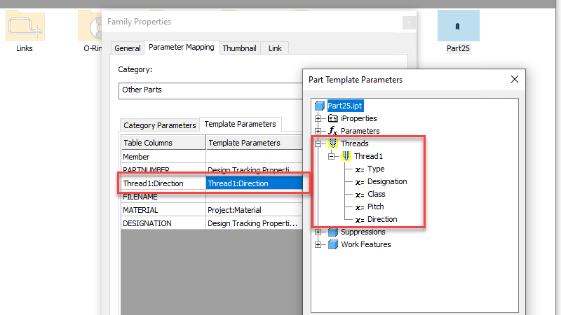

With this release, it is now possible to map the thread direction (left or right) to the part template parameters.
Using the Content Center Editor add a new column into Content Center family table. Fill in the desired thread properties defining the thread direction and map this column to the family template Thread Direction available in Family Properties > Template Parameters > Part Template Parameters.
