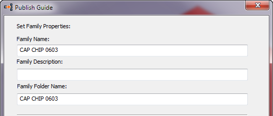

Important: If you already have an IDF component in the IDF Content Center library with the same family name and part number, empty the existing IDF component cache folder of the family before you import the IDF dataset and reuse the published components. For example, ...\Inventor\Content Center Files\R[release number]\en-US\[Family Folder Name].

Important: Empty the cache folder of the existing IDF component family before you import the IDF dataset and reuse the part.
