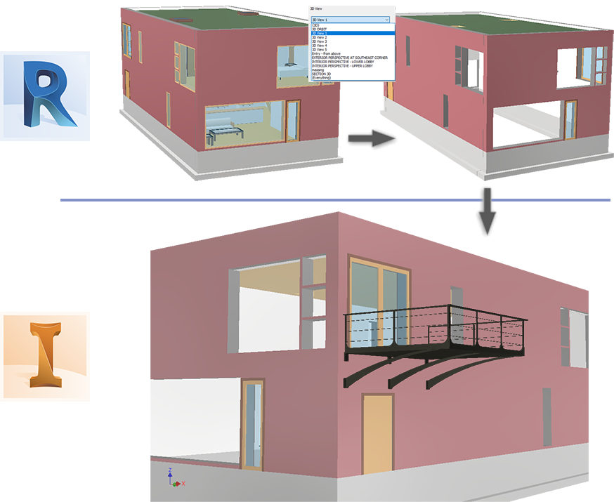

AnyCAD functionality is extended for Revit to help manufacturers in the construction industry collaborate and coordinate on BIM projects.
Revit File Import Enhancements
(Not available in Inventor LT)
Revit 3D data can be referenced in Inventor assemblies making it easier to create accurate, up-to-date product designs for manufacturing. When the referenced model is modified in Revit, Inventor receives a notification. Click the update command to see the changes. Components with dependencies, such as constraints or projected geometry, update.
