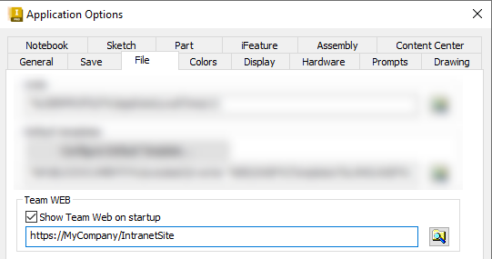

  1. Access the Application Options dialog box.
  2. On the Files Tab, specify a web site or a file in the Team Web field. This can be a link to tutorials or the file or URL of your choice.
    Check the box to replace the Inventor Home start screen with the specified Team Web page.
Use Team Web

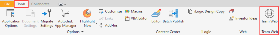

After you set the Application Option, you can start Team Web in two locations:
  1. From the Home Tools tab Team Web panel.
  2. From the Help menu drop-down.
