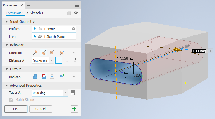

  • Extrude
    When using the taper option with adjacent regions, the operation merges the faces to create a single, unified result.
    To learn more about working with Extrude see To Create Extruded Features.

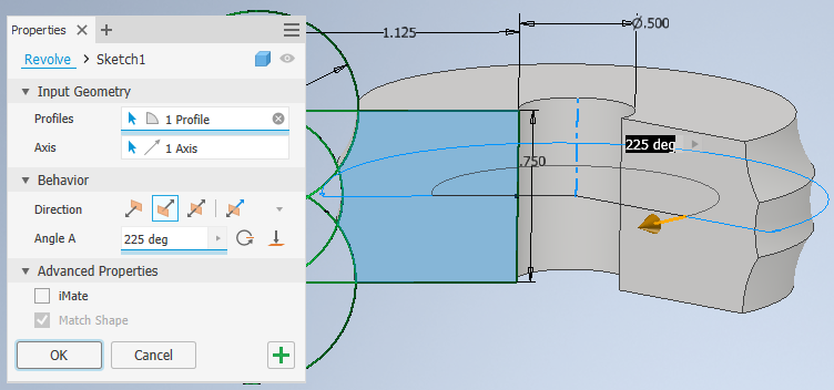

  • Revolve
    To learn more about working with Revolve see To Create Revolved Features.

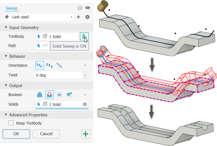

  • Sweep
    In addition to the property panel, the Sweep command now supports sweeping a solid.
    To learn more see To Create Sweeps.
