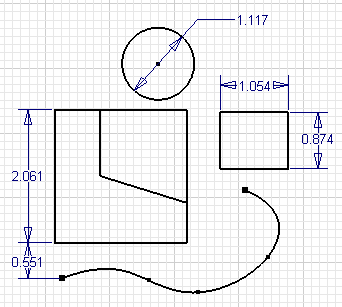

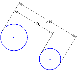

The list below illustrates the entire set of dimension constraints exposed by the API.
DiameterDimConstraint
Diameter dimension constraint
EllipseRadiusDimConstraint
Ellipse radius dimension constraint
OffsetDimConstraint
Offset dimension constraint Offset dimension constraint
RadiusDimConstraint
Radius dimension constraint
TangentDistanceDimConstraint
Tangent distance dimension constraint Tangent distance dimension constraint Tangent distance dimension constraint
ThreePointAngleDimConstraint
Three point angle dimension constraint
TwoLineAngleDimConstraint
Two line angle dimension constraint
TwoPointDistanceDimConstraint
Two point distance dimension constraint

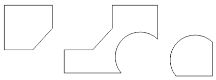

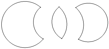

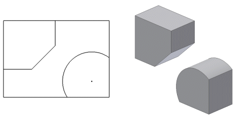

Profiles in Part Documents
Another important concept that's not explicitly exposed through the user interface is the concept of profiles. A sketch is essentially just a container for 2D entities and their associated constraints. The sketch itself does not define connected sets of entities that can be used by a feature to define its shape. This information is defined by profiles. You can create the following sketch in Autodesk Inventor.
Profile sketch
When creating an extrude feature, the first step is to define the profile. This is done interactively by moving the mouse within the different closed areas and clicking. Any combination of the following three shapes can be used to define the profile of the feature.
Profile shapes
In the API, the profile is an explicit object that you can create to provide input to features and can also obtain from existing features. A profile is always associated with a particular sketch and essentially adds topological information to the sketch. Coincident constraints between sketch geometry controls which shapes can be defined from a given sketch. For example, if you create a sketch containing the two circles shown in the following figure and use this sketch for an extrusion, you can only select the inside of the circles.
Two circles
However, if you place sketch points at the intersections of the circles and tie the points to the circles using coincident constraints, you can now achieve any combination of the following three shapes.
Three shapes

Extrusion sketch and resulting figure
The profile obtained from the feature contains two ProfilePath objects, which are highlighted in the following figure. Each ProfilePath object returns a list of ProfileEntity objects. The ProfilePath returns the ProfileEntity objects in the order of how they are connected to each another. The ProfilePath also tells you if the path is open or closed and if it adds or removes material from the profile.
ProfilePath objects
The ProfileEntity objects provide information about each piece of a ProfilePath. The ProfileEntity objects are oriented so they are connected head-to-tail to one another. ProfileEntity objects don't exist graphically within Autodesk Inventor but are simply an intermediate step between the sketch and the feature. A ProfileEntity returns the underlying sketch entity and the two sketch points that define its start and end. The underlying sketch entity will in many cases be different from the profile entity.
Let's look in detail at the previous example. The sketch that was used contains seven lines and one arc, plus all of the sketch points and various constraints tying it all together. From this sketch a single profile was created and used as input for the extrude feature. The profile consists of two ProfilePath objects, which when used for the extrusion resulted in a single solid with two enclosed volumes, as shown in the following image.
