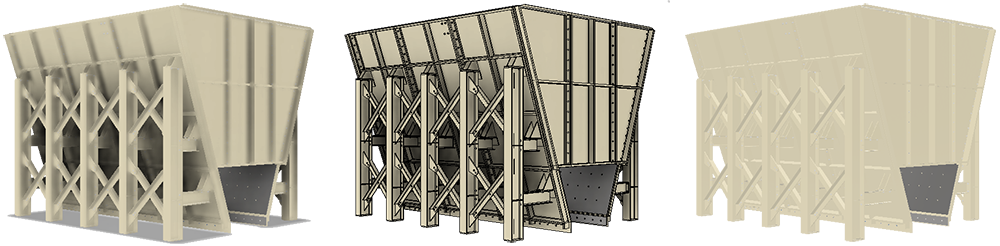

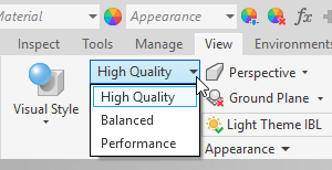

Graphic Presets
Three new Graphic Presets provide a look and feel for working with your designs.
- High Quality - places emphasis on providing pleasing visual results utilizing a new IBL lighting style Light Theme IBL, Realistic visual style, and shadows. Best used for high visual quality in product demos or final quality ray trace renders.
- Balanced - places the emphasis on both visual display and performance. Balanced is the default setting for built-in part templates utilizing the new IBL lighting style Light Theme IBL, Shaded with edges visual style, and ambient shadows. Ideal for working with parts and small-to-modest sized assemblies.
- Performance - places emphasis on performance over visual display. Performance is the default setting for built-in assembly templates utilizing a new lighting style Light Theme, Shaded visual style, and no shadows. Best used for working with medium-to-large assemblies.
To learn more, see Graphic Presets.

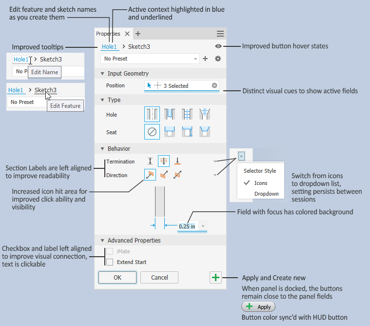

Property Panels
Property panel layout and buttons are enhanced.
Feature naming during creation is an
An Inventor® Ideas submission.
