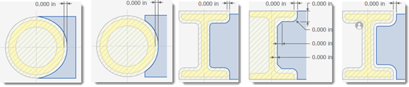

Notch
The Notch command is now a property panel. In the new panel, you do not need to select an option to notch multiple members at the same time.
Previously, it was difficult to create a custom notch. In this release, you can now specify the following:
  • Basic Profile to set a single offset value.
  • Custom I Template to set multiple offset values.
  • Custom Profile, if available, to use a custom notch profile saved in the Content Center family.
  • Check the new Perpendicular Cut option to create precise intersections.

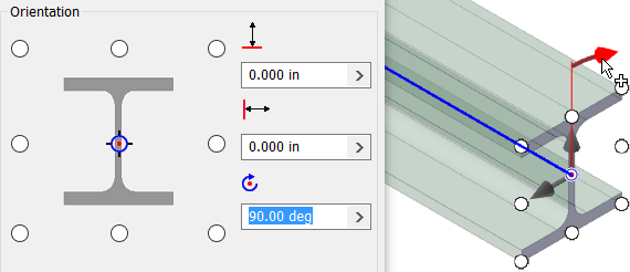

In-canvas Orientation Tools
You can now interact with in-canvas manipulators when you insert or change a frame member.
