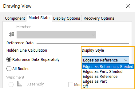

The Drawing View dialog box is enhanced to allow you to create shaded views of referenced parts. The Line Style settings section is renamed to Display Style and updated as follows:
  • 2 new options for creating shaded views of referenced parts are added:
    • Edges as Reference, Shaded
    • Edges as Part, Shaded
      The 2 new shaded options are available only when a base, projected or section view is placed and contains reference parts.
  • 2 of former Line Style options are renamed:
    • As Reference Parts is renamed to Edges as Reference
    • As Parts is renamed to Edges as Part
